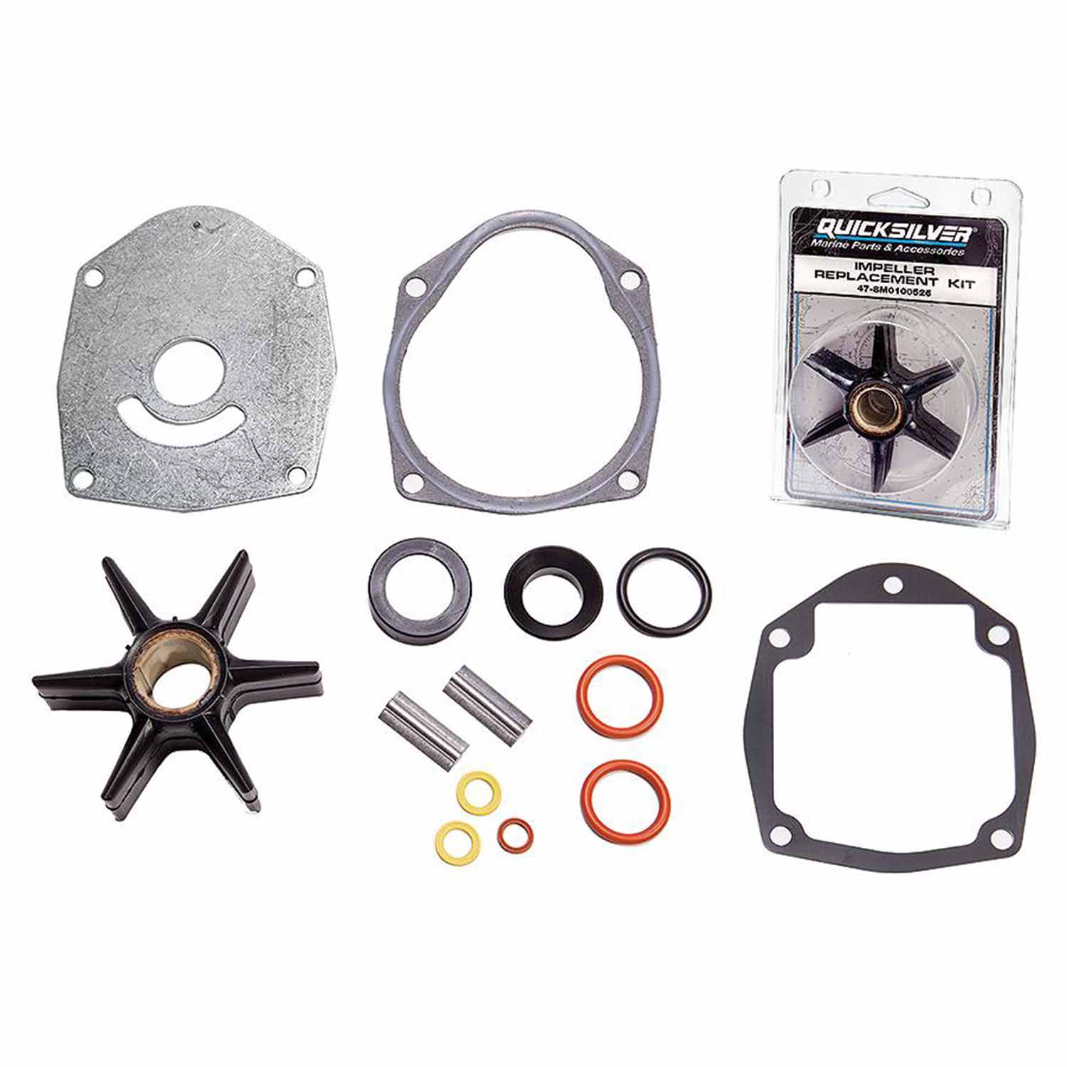

Did you replace the whole water pump assembly or just an impeller?
I recommend the whole pump kit
Scott06
Apr 20, 2014
7,620
on a gen two unless housing is scored there is no need. The stainless housing is much more robust than the earlier plastic ones. Merc has a kit with impeller baseplate and gaskets for about $55. Unless it was run dry forever thats all you need. Many places to buy but this is the oem kit merc and quicksilver are the same .
