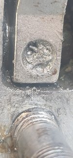

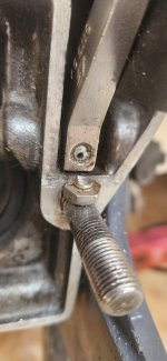

Help! I screwed up! I was putting the Bell Crank back on the boat and was tightening the bolt that holds the shift lever on the bell crank. The original OMC Shop Manual said 5-7 ft -Lbs. I was using a torque wrench. I got to 5 Ft-lbs and was going just a little more…
The bold was sheared off !!! See pictures.
I am trying to remove the bold. I have tried drilling a small hole and using an Easy Out. I was making progress and had a small hole and put in the Easy Out which then snapped off $%$#@. I should have made the hole bigger and then used a larger diameter Easy Out.
And now there is a Very hard Easy Out in the hole %$#@.
I started drilling a new hole and was making progress once again, and then … I snapped off the drill bit. The Shift Lever can move, and that caused the bit to bend and break %$#
I spoke to a boat mechanic who said to use Cobalt drills, go very slowly and apply a lot of pressure.
I have been using cutting fluid.
Once I get a hole large enough for an Easy Out, this time a bigger one I plan on heating the lever with a torch before trying to remove the bold.
Any suggestions?

Here are the pictures. The first 2 are before I snapped off the Easy Out

I think that bolt snapped because the end of the bolt, may not have been seated in the recess in the bellcrank
so I think you have 3 choices:
reverse drill bits
remove pivot housing and take it to a machinist for repair
replace pivot housing with another one off of ebay if you can't find a machinist locally, there are usually a number of them available with the bellcrank installed

I can't really be sure why the bolt snapped, but it was seated properly in the bell crank's recess. I lined up the parts and, at first, hand-tightened the bolt. Even with the head snapped off, the shift lever is secure to the bell crank with very little play.
Re options: 1) Reverse drill bits. I will look for some. Do you recommend Cobalt, black Oxide, or something else? I will open up a hole large enough to get a larger Easy-Out in before I try to remove the broken piece.
2) Removing the pivot housing; I just reinstalled it, and I hope not to do that, but it is an option.
3) Whole new pivot housing; I'm pretty sure that I will not have to do that.
Re quality. I agree. This is a 92 boat. It lived on a lake for it's first 20 years then on a dock in salt water 24/7 for 5 years, now on a trailer and washed off after every salt water outing. It's is pretty good shape.
I'm going to try drilling, again this morning and if that does not work then off to a welder to try to weld on something that we can grab ahold of and apply enough torque to remove it.

A machinist with a welder tried to weld material onto the broken bolt. The plan was then to grab hold of that material and unscrew the bolt. He could not get that to work. At one point, he accidentally welded the bolt to the shift lever. Now we are considering removing the pivot housing and putting the whole thing on a drill press and drilling a hole in the bolt and removing in with an Easy-Out.

The machinist got the broken bolt out, but it was not easy. I had to remove the pivot housing, then he put it on a drill press. That worked, but it all cost $450 !!!! That was an expensive lesson on overtorquing something. I was using a torque wrench. The wrench has a long handle and it was east to overtorque the bolt. Next time I will just use a 8 inch socket wrench. I will also use a low strength thread locker to prevent the bolt from backing out
I also learned a lesson about Easy-Outs. They are brittle. I should have gradually opened up the hole and used a larger Easy-Out. That may not have snapped.
Another lesson would be to confirm the hourly rate before working with a machinist. It would have been cheaper to just cut through the bell crank and replace both the crank and lever!!
I was able to save the shift lever by drilling out the hole a little larger and tapping in new threads. I went up tp 5/16 - 18. I will use a stainless steel socket head cap screw and the thread locker I mentioned above.
