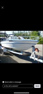

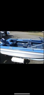

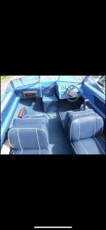

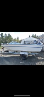

Hello everyone I am new to boating, 7 months ago I went to a marina (pudget sound marina) in lacy Washington and fell in love with a 1979 suncraft 18 foot boat. They had the title to the trailer and boat and were asking 3000.00 for it, they took me out for a spin in it to show me it worked and that was it I had to have it. I explained to them that I was there to buy a boat and that I was new to the whole thing, I asked them to show me somthing that would be lake ready ( this was my mistake trusting them as they had outstanding reviews ). So in the 7 months of owning it I have rewired the boat to get rid of the tube fuses and install a marine grade circuit breaker, repaired the chips in the gel coat and the keel, replaced two coil packs, added a voltage gauge, added a bimini top, replaced the fuel lines, and rewired the trailer and added new trailer lights. In the near future I am going to replace the trailer tires, hubs, and get a new stator for the 1979 evenruide 115. I also discovered while I was replacing the speed sensor on the transom that the transom has water in it.... So my plan as of right now is to rebuild the transom using marine plywood and fiberglass and while I'm at it I might end up doing the stringers as well if needed. I have tried and tried and tried to look up information on this boat manufacture but can find nothing about it. Does anyone know anything about this brand or boat?

first, all the information that is important is in the title and registration. I assume you have that. if not, you own a yard planter
now, assuming you have a title and registration in hand. what does the title say the boat is.
beyond that, what other information do you need. other than 4 boat manufacuters (out of about 150,000) there is no manual or other useful information.
if your transom is junk (high probability on any boat over 15 years old) then you should also plan on stringers and doing the floor.
all the information you need on restoring a boat is going to be found here: https://forums.iboats.com/threads/how-tos-and-other-great-information.283508/
read links 14, 15, 18, 2, 3, 4a, and 4b in their entirety.

Welcome aboard. Sharp looking boat. Your screen name shows you know what you are in for getting it where you want it to be. A lot of time getting there but the end result will be something you will be proud of.
I noticed in the one picture your rider is wearing the most uncomfortable type of PFD made. Get some that are comfortable to wear. As some one that had to wear a PFD for 8 hours at a time for work I would suggest looking into an inflatable (Like the Mustang Line or similar). Makes for a happier passenger.
