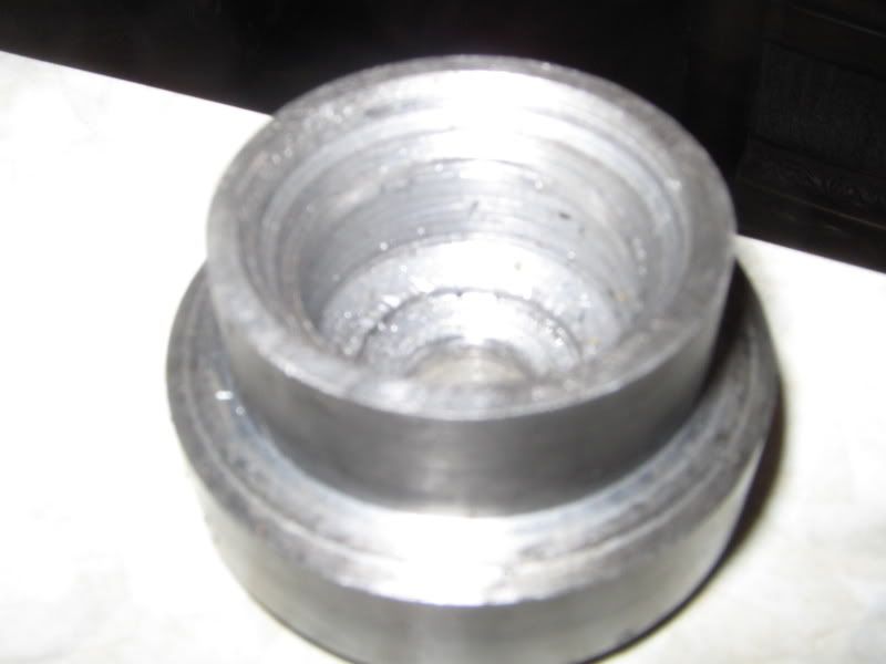

I use a torch to heat up and remove the center part, burn away some additional rubber remmnents, use a socket to try and drive the spacer ring and outer shell of the motor mount out.I use this item that I made to install them.
The part with the small shoulder goes on top,the 1/8 th inch lip self-centers in the housing, that is clearanced for the top of the bushing.the large shoulder part is the bottom and is clearanced for the bushing and about .010 undersize so that is applies pressure only on the outer most part of the bushing and is able to recess into the housing to allow the new bushing to be drawn to is proper spot (all the way in)
works a lot easier and better that trying to drive then in all the way and risk cracking the rear housing.

Thanks for the link, I knew it was here somewhere. Sorry...it is a 3.0 mercruiser. I have a set of tools that i borrowed and it has pieces exactly like the ones pictured to install the bearings.....

Ayuh,... Nice little press BD....
