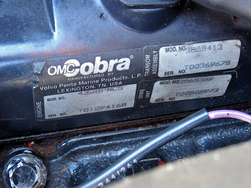

Just double checking my model is 1996, here is valve cover plates:
and outdrive plates:

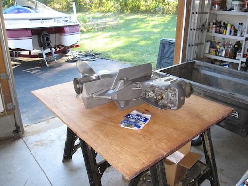

Outdrive is on worktable, with gasket kit, awaiting this weekend for re-build.

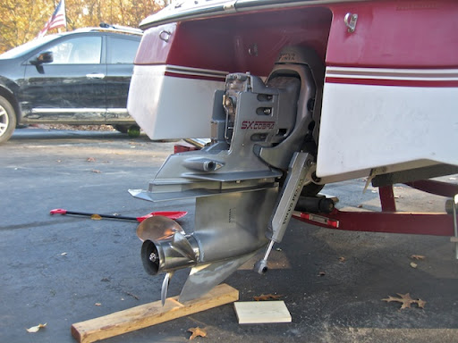

Well, finally got the outdrive shift seal installed and the outdrive back onto the boat.
A couple of things to share:
This crusted stuff was blocking 97% of one side of the exhaust flow.
(this pict from earlier post I asked what this was)
I removed it, is that the infamous Exhaust flapper I've read about possibly?
I wonder how the crusted junk blocking the exhaust port on one side affected my engine.
Now clear passage!
The little roll pin (tension pin), when you push it into the brass part (eccentric piston) to remove the steel dowel (eccentric piston pin)
You have to hit the eccentric piston with hammer, the tension pin will come out...at first I was not hitting hard enough and was getting frustrated.
(step 6)
Greased u-joints and gimbal bearing
I was sorta worried on the whole re-assembly.
Followed the instruction manual, grease here, gasket sealent on 6 bolt threads, new H20 gasket, oil on spline seals (not grease), etc.
W/o a hoist definitely a 2 person job.
I lifted the outdrive close, my wife helped align the shift linkage thru, I guided the spline, moved the porp until it slid home.
Torque everything per specs and pattern. Attach shift linkage.
Got time for dinner/etc, cleaned up, next week will fill gear oil, fire up the motor, and hope everything works.
Then, time for winterization.....Yea I'm about 2 weeks behind where I usually am doing this but we are having warm weather here...

by removing the ss prop you could have lightened it up a bit, other than that I use string or bungees from those fancy chrome ski tow eyes to hold up the trim rams so I dont have to remove the front anchor hardware to reattach the rams.
other than that it looks good. I warned you about that shift pin :).
its a real pain when I get a unit with a second pin installed, and yes it makes dissasembly again rather interesting.
