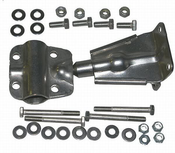

Here is the steering telescopic cable and the controls.
You might try this hardware out to secure the steering cable to the transom.
It's made by teleflex.
Oh, and I would suggest a 25-40hp Johnson 1970-1985. Make sure you measure the length of your transom first, to be sure that a short shaft outboard will be suitable (Transom height < 15" {short shaft} Transom height > 15" {long shaft})
