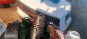

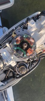

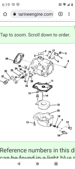

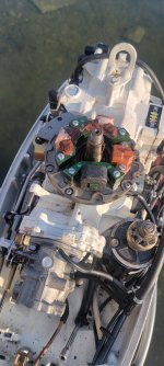

Doesn't that carb have a plastic top? And are the throttle rollers in good shape?
Before you by passed the vro I assume. Have you tried pumping the fuel line ball to see if it runs better? If so that would point to the Amazon fuel pump you bought.That's the only pic of the carb I have on my phone.
Yes there is only one. That needs to be in 1 piece does it have a clear covering on it? Do both carbs move at the same time. Maybe time for you to invest in a factory manual.It's only on the bottom carb?
Fuel problem. I would replace the fuel pump with an OEM one or better yet rebuild the vro.Before I did the vro delete the motor had a hard time idling but was manageable. Yes pumping the primer bulb helped the performance of the motor and kept it running. After the delete the motor doesn't seem to stall out while driving but has no low to mid range power. It also wants the choke fuel inrichment on to run.
