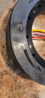

Just watched a video on a sheared woodruff key. Assuming when the flywheel is pulled the correct way, the woodruff key keeps things lined up. Just got my new stator but wires on top are exposed. Now delayed waiting for replacement. Bummer

Your motor looks to be 80's or 90's. Not many Mercs of that vintage have traditional woodruff keys. Those Mercs have a "W" shaped where the flywheel and crankshaft mate. The inner flywheel can only go on one way.
Now the outer flywheel can go on 6 or 8 different ways......

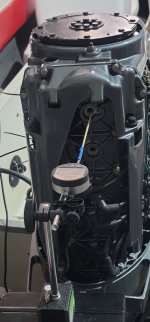

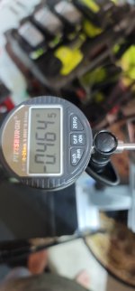

1986. You guys hooked me up. I went back and tried to align the rust/stain marks. Worked and both 0 and .464 line up. Flywheel was both put on loose and wrong last time it went for maintenance.
Now I wait for the new puller and holder and will do all the swaps. Will result in a completely new ignition system from key to spark plug.
