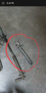

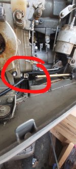

Need pictures for reference for my '72 evinrude 125hp throttle/shift linkage at the motor end. If anyone can help out with some pictures of there motors linkages off a early 70s Johnson or evinrude that would be great. Im missing parts and want to make sure im ordering the right thing, ive already got wrong part once. Thank you

Pictures or part numbers of the " wrong " parts ?-----And where did you get those parts ??

Im looking for pictures. I do better with visuals. Shows me what the part looks like as well as how it is connected. Parts were off a parts motor but they were not correct,

I worked at a dealer when those motors were NEW.------I know what they look like.-----Where did you get your parts ?----Off of what motor and what did the parts look like.----Pictures from you.----I do not know how to post pictures.----Don't want to learn either.

The motor came with a 85 hp parts motor and it was in a bag of parts but i think it was off lawn mower or something like that, It was far too small.

I think this is what i need but im not 100% sure on that

Ok, and it just goes on the end of the cable and clips onto that nub in my 1st picture?

Just a fill in update, after alot of rewiring, part sourcing and learning ive got this motor running.
