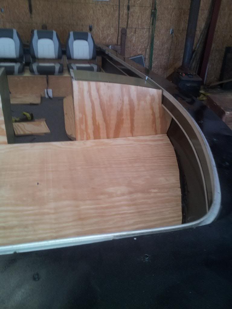

Thanks guys I appreciate it. So I am actually trying to decide which part i want to hinge the top where the seats actually mount or the bottom to slide things in and out.
If you look at where the ply meets the splashwell you can see I kept the original starcraft sliding design I just shortened the doors so there is still access to the bilge that way and it is big enough to slide the battery in and out.

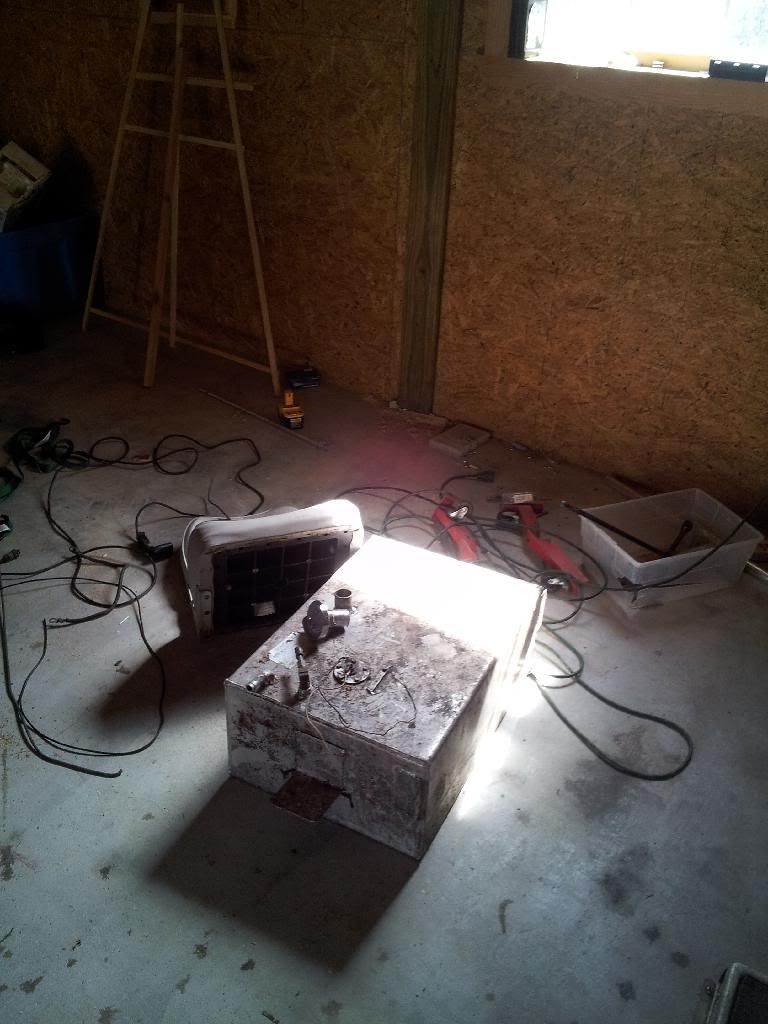

Started cutting the glasser up today, it had a really nice 18 gallon aluminum tank in it, of course it was stored with about 6 gallons of gas in it.
SigSaurP229
Oct 1, 2008
2,123
Re: Here we go with the 16ss

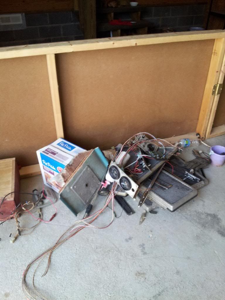

Gas tank very usable gas not so much.
Cleaned up really nicely with all purpose cleaner and a garden hose.
Pile o parts

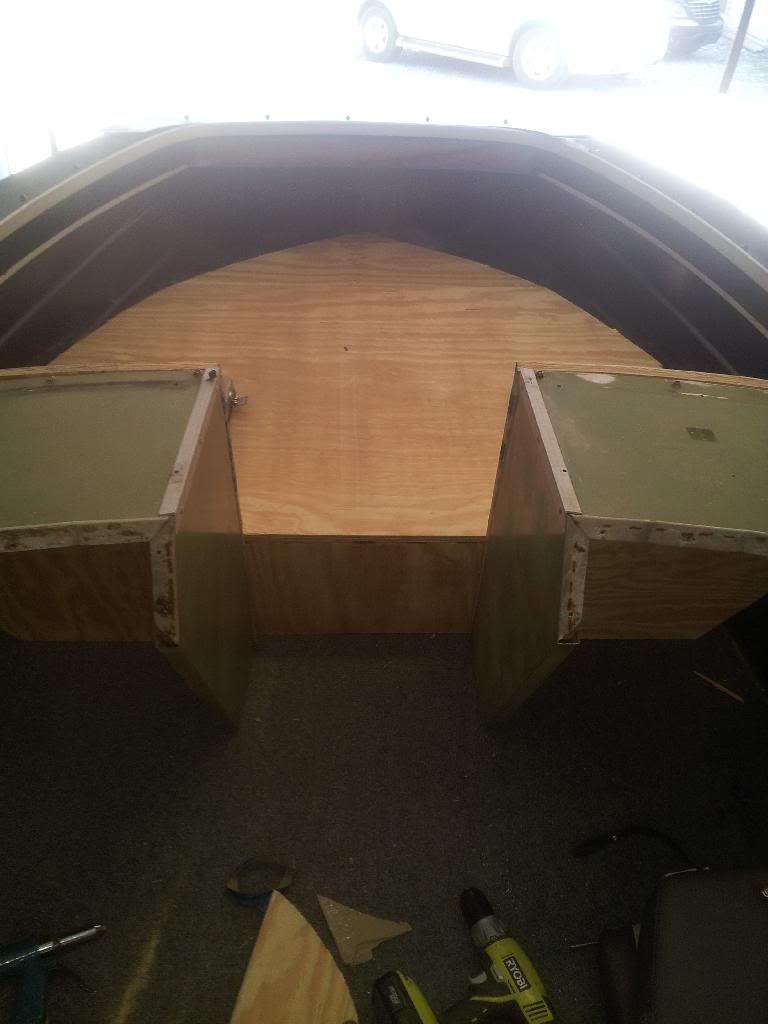

SUWEETTT. Having child care during the day ROCKS. I started at 9:30 this morning finished all of the major carpentry by 330 built seat boxes, all the under deck framing for the forward deck all the support structure for the rear bench seat, I mismeasured and had to raise the rear bench seat by 3/4" the gas tanks dips down a little farther than I had anticipated.
