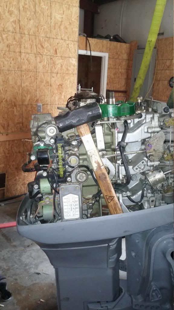

Because you know someday's there is only 1 tool for the job.
anyways on with the real stuff. The hardest part of the day was going through the Pile O' Bolts the previous owner of the engine was nice enough to leave me, to put the lower housing back together it has basically been dangling free it took two hours but I finally got her together.
anybody happen to notice where the motor is sitting now? :) She is now bolted in.
We have a little problem though I can't install the lower unit until I get the new flywheel key so I am kind of in hurry up and wait mode on that aspect.

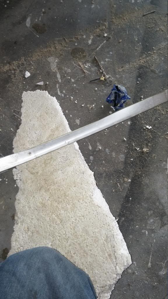

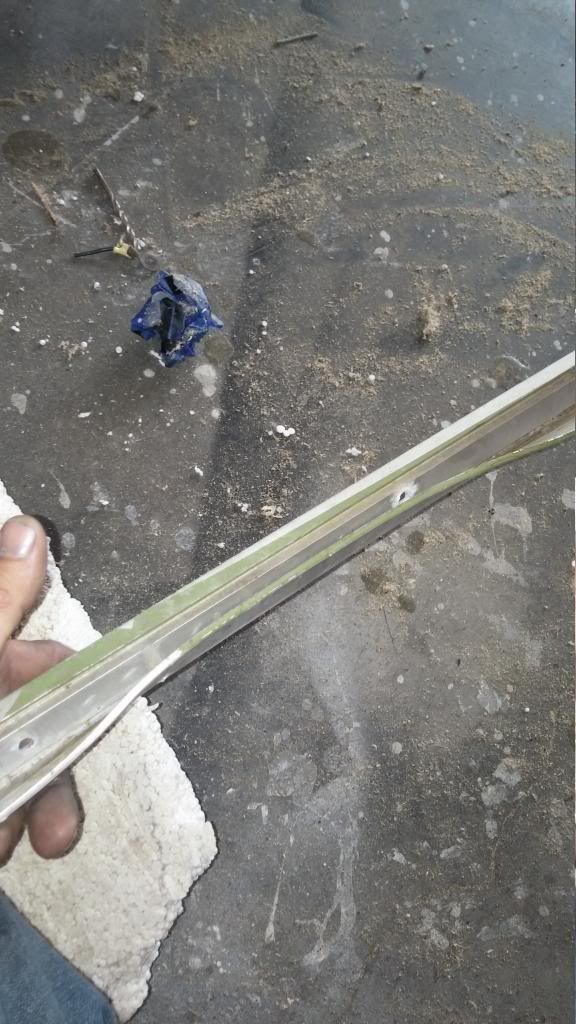

anybody happen to know any tricks or tips to fix this mess?
It's gonna be alright now because you're using my favorite tool. :happy: The trusty BFH!
Hey - Ya got her hangin'. All that's left is stuffin' the lower up there!
I usually sweep the dust and junk under a rug. But I don't see a rug. :eek:
Wait a minute, you want to unfold the lip on the the trim. If you start bending it, it will break. An idea, I don't know how well it will work, but try annealing the AL. That softens it and hopefully you can re-form the lip. Here a forum thread from Practical Machinist on the "how-to": annealing aluminum sheet , help Be gentle and work slowly after annealing.
