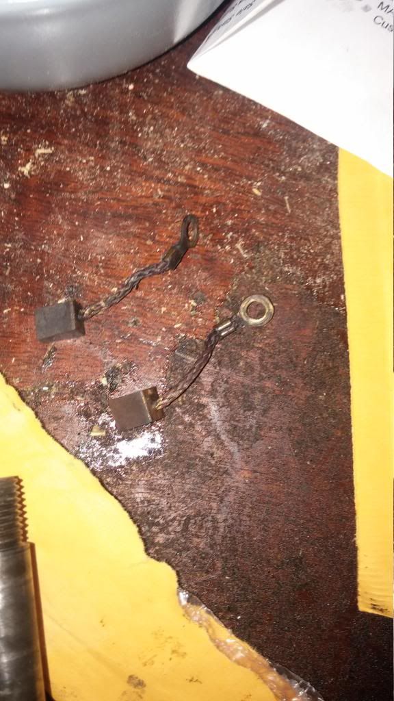

Anyways, for anyone that has never seen the inside of your starter. Here she is being rebuilt.
Old brushes they really don't look that worn out.

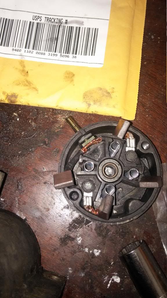

New brushes installed.

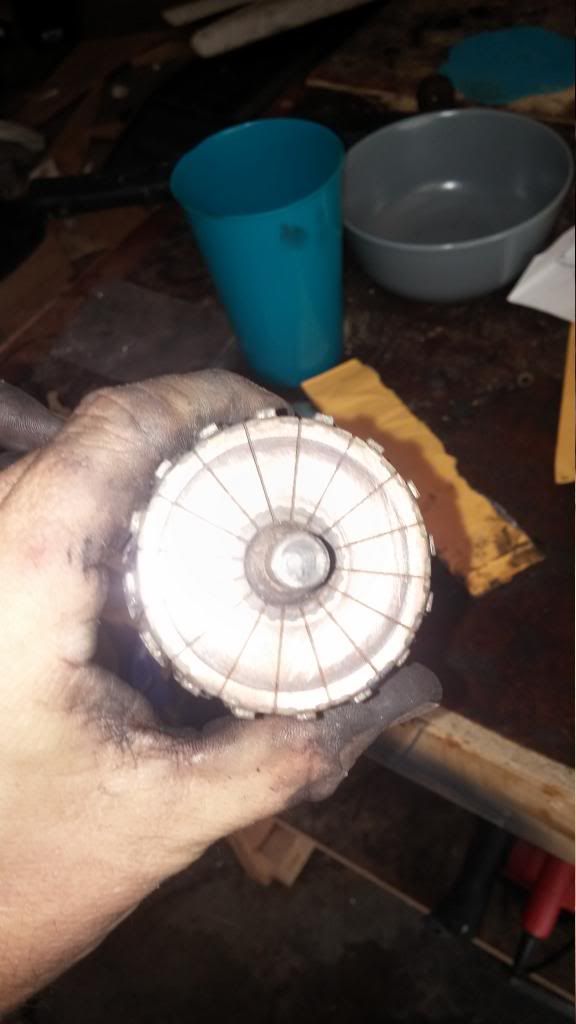

The bottom of the armature after cleaning.
The worst of this job is installing the new brushes. I have a fabbed metal plate that I use to hold the brushes into place while reinstalling the armature and housing. The main thing is cleaning all the contacts and don't install the negative and positive brushes backwards (I have done that before it lets the magic smoke out).

I've never opened a solenoid before most have been have basically been wrapped in plastic. The windings looked good, the brushes didn't look to bad, mostly what I found was just a ton of dirt and grime and carp on the bottom of the armature and in the brush plate. I don't think I have ever really seen one so nasty. I honestly think I could have reused the old brushes cleaned it all up and it would have been much better.
