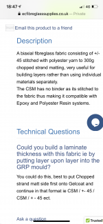

That’s what I initially thought ,and that’s exactly where the hinges for the hatch are screwed from above but the fiberglass is so thick the screws don’t penetrate the aluminium,so it’s not really doing anything and the screws in the hinges are holding fine , I don’t think the ally is adding any Strength to the deck infact I think it’s actually loosing strength as it wasn’t bonded in correctly, hence why I’m Considering not putting it back , I’ve got a nice piece of mahogany that’s about the right size, would that be ok to use and bond in with epoxy thickened with west 406 Colloidal silica and glassed over with 1708 ? I assume you have to prime the wood first with un thickened epoxy first and let it kick before adding the thickened epoxy and clamping it into place and then glassing over when it’s kicked ? I’m assuming I don’t want to wait for it to fully harden as I would then need to sand the amine blush off? I’ve been reading on her for a while and watching you tube videos , so hopefully I’ve got the right idea ?sorry for all the questions I’m new at this fiberglass stuff

you cant use epoxy with 1708. you need the styrene in the poly to dissolve the binders in the CSM stitched to the 1700 cloth.
I would have just used poly.
regarding the aluminum screw strips. the screws should have gone to the aluminum. however most boats suffer from very shoddy workmanship from the factory. (remember, boats are slapped together with the minimum amount of effort to get the maximum profit and only designed to last 15 years)

Hi I think the combi mat supplied in the uk is compatible with epoxy , also how do I get to the links you have supplied
