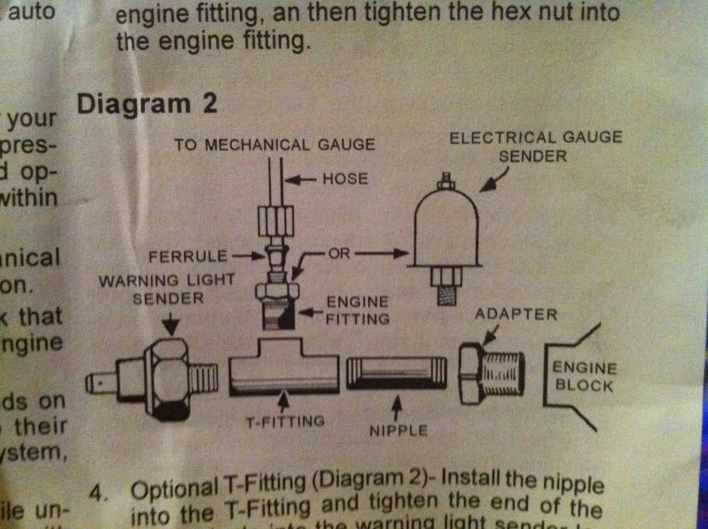

Here is the mechanical oil pressure gauge I bought but dont know how to hook up after reading the directions.
It says something about needing an adapter and a tee fitting. Is this stuff I have to buy or what. It gives different kinds of directions for different kinds of senders. I see one on the top of my engine that looks like the one in the pic but maybe the sender is the thing that is above where the oil filter goes with the wires connected to it? I dunno.
Any idea? Suggestions? Sorry for the long post. I appreciate it.
