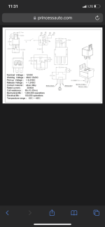

These are the relays I picked up, see attached picture of the manual. Does it look like the right gear for the job?

Yeah they'll work, but they don't appear to have a diode I mentioned above.
You're driving the relay with a mechanical switch, worst case w/o the diode, it could shorten the switches life some by arcing HOWEVER that circuit is most likely isolated from the rest of anything that might have issues, so its not too critical.

You can add diodes(MOV's) externally if you like, just follow how they did it in the schematic your post above.........This is done usually if the relay doesn't contain one.
Hey Sam I am, got it all geared up now, for what it consisted of it was a lot simpler than I though once I got all the wire straightened out and got a good look at it. Still don’t understand the wiring diagram though lol.
Turns out the oem diodes were external to begin with and had heat shrink on them. They looked to be in good shape so I reused them. Works great, and all fits back in the factory box which is nice! Now if I ever have to replace them it’s just a quick run to the auto store for some relays.
Thanks again!
