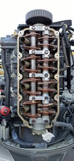

I'm having trouble removing the timing belt driving pulley. Any tips? I don't have the special tools describe in the manual. It seems like a good impact driver would loosen it, my dewalt 20v impact didn't do anything. Also with the timing belt off, when removing the pulley, you probably don't need to line the timing mark to tdc anymore right?
ahicks
Sep 16, 2013
3,957
No need to remove the pulley I don't think. I usually remove the idler pulley and just slide the belt up and off the cam pulley. Pretty easy. Tie the belt so its forward, out of your way while you're at it....

Thank you. I was able to remove the cylinder head without removing the pulley. The manual instructed to remove several other parts too and they didn't need to be removed.

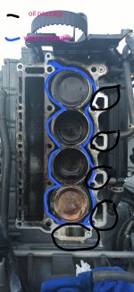

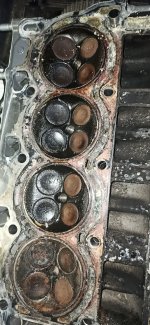

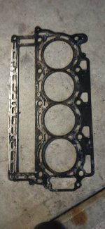

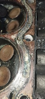

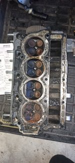

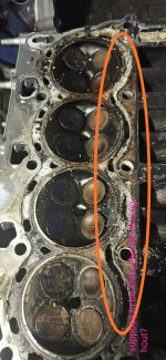

Well, I don't think the cylinder head looks good.
- Near cylinder 4, on the exhaust side, I see a pinhole and missing aluminum. Maybe I can clean out the oil and exhaust and weld it up. it's really small. no cracks.

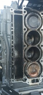

- No cracks on the cylinder block I think. I don't see much obstruction on the block side of the engine.

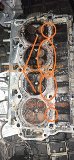

- Head cylinder, lots of salt build-up. Very very packed. I'm looking at pictures of what the head suppose to look like and those water passages are suppose to be cleared/have grooves and channels for water flow? It's pretty gunk up around cylinder 1, between 2 and 3 and 3. All on exhaust side.
Can you guys take a look at the pictures and provide me with some insight?
This is an old engine, per engine frame, it's a 2003. So 18 years, and probably spent a lot of time in salt water in Bay Area. When I bought the motor, the guy showed me maintenance invoices and what not, i can't remember when the motor was last run by them. But I bought it and used it probably 20-30 times. Again I always had issue with telltale constriction, but it always started up and run, and compression isn't that bad.
My thoughts on this engine right now is that if I can just clean up the salt build up/gunk, patch the exhaust pinhole and then sand the head flat. Then reinstall with a new head gasket. At least then the water passages are cleared, maybe I can get couple years on this motor?
The other option would be to get a new cylinder head, which is more than $600 itself, then add in the cost of all the other parts, might be in the thousands. hmmm decisions.

That third picture where the block is completely plugged up, that would convince me to try one of the chemical solutions for removing that stuff, assuming you cannot physically get to all of it after disassembly. Get on youtube and look for videos using rydlyme or barnacle buster to dissolve that kind of thing. The chemicals work, the chemistry makes sense, the question is the risk to the metal, especially any anodes in the motor. But in your case, if that were my motor, I would take the chance. The method that makes the most sense to me is removing the thermostat(s) and the lower unit, attaching a small pump to the water pick-up tube, put a bucket under the motor and use the pump to keep the fluid re-circulating around the motor for a while. Here's an example of one of the chemicals working:
this looks promising. I just fear it will eat up the aluminum. :) But now that I have the head apart, chisel, hose and air compressor hopefully will help.

First, I'm not an expert on 130's. My experience is all on 40-90 hp. The bigger stuff is too hard for this old man to handle easily, and the small ones keep me as busy as I want to get....
Clearly you have a mess with that head, especially as concerning the areas that have perforated. I'd say that's where you water and oil are mixing.
If you have access to welding, I'd say get it all cleaned up, then make up your mind about whether or not you want to replace the head. Concern here would be regarding the potential for other holes to appear. A little poking around with a sharp awl/pick in order for sure.....
I would second the idea of having a good look at that steering arm/yoke with the amount of salt this engine has seen. This is a pretty common issue, and not just with Honda. For some stupid reason, these are made from what appears to be cast iron, and do very poorly in a salt water environment. I've seen the steering arms break right off....
1000 sounds like a lot of money at this point, but if that leaves you with a solid motor for years to come, I'd consider that a pretty good investment. You darn sure aren't going to replace a motor like this for any less....

Try really hard to identify where the water was getting into #4, was it coming past the head gasket somewhere? I don't think the missing metal on the exhaust side was the water source. Also I suspect that whole area where the hole is, is probably very thin metal at this point. If you weld it, try not to get enough heat in the head to warp it or you'll need to machine it flat again to get proper head gasket seal. If you can weld up that hole yourself, I wonder what a local machine shop would charge to clean up the head and make sure it's flat? Option 2, see if you can find a used take-off head from a fresh water motor for a reasonable price. Great job so far, disassembly was definitely 100% required so good call on that.
