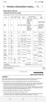

I don't know if my BF 40A sn BAYL-2000515 wants an initial 1 5/8 turn out on the new replaced pilot screws or 2 1/4.
The service manual seems to indicate BAYE and subsequent want 1 5/8 turn out.
It will not idle except with about 1/4 choke.
Carbs were balanced but the idle circuit must be clogged?
If i close the choke it will not idle (it dies).
I can close the pilot screws (fuel mixture) on each carb and it doesn't seem to make any difference.

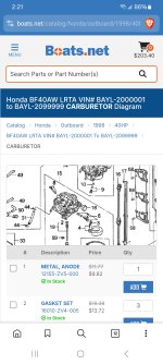

The carbs were solvent cleaned (don't have an ultrasonic cleaner) twice. I will take them apart again and this time use a remote tank to get it running while I take steps to clean the on board tank since it must be getting dirt from the built in tank.
I have replaced the jets gaskets and orings last cleaning and I ordered another set of orings for this cleaning.
I also ordered 3 carb covers (part 18) since the bottom carb was leaking when I squeezed the primer bulb...which I read can be caused by a clogged main jet.
I think the carb cover seals is just a press in fit. I tapped the carb cover in and the leak quit so not sure I should replace them.
I will check out the gaskets and isolators when I disassemble them....or should I replace the gaskets even if they look okay?
