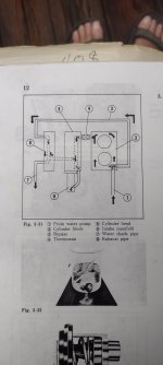

There are two circuits from the pump, the tell tail is simply a telltale. The other circuit is doing the actual cooling.. maybe this will help...

thanks flashback...that helps. the confusing part is that the thermostat seems to be housed moreso in the inlet manifold than the cylinder head.
and if I'm hearing you right, the telltale just indicates that the pump is working. it doesn't really participate in the cooling? it does get quite hot

flashback
Jun 28, 2002
4,288
You have the gist of it, the thermostat holds water in the block until the temp opens it up, then the hot water is released to the exhaust. You probably should get a thermostat. I think cool water is just moving thru the engine without the thermostat and passing hot water thru the telltale the way it is now..

flashback
Jun 28, 2002
4,288
You're lost me but maybe this will help you
flashback
Jun 28, 2002
4,288
I think that what you don't see is if the thermostat is not there the water just flows freely thru the motor and offers very little cooling..

If you look at the diagram I posted you will see the fresh water goes directly to the block and excess goes to the telltale.. when the water in the block reaches operating temperature the thermostat opens an allows the water into the head and then out the exhaust..

yes the first diagram made sense except the thermostat. it should be located on the left side of the cylinder head and it should extend into the inlet manifold. the
The intake is always cooled by the excess and that's good..

flashback
Jun 28, 2002
4,288
That diagram came from an old factory manual I have lying around from 1979..
