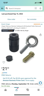

Also, I bought this from Amazon to lift the motors. Have people had good success with using this?
Thanks
Jiggz
Oct 23, 2009
3,909
Unfortunately, the flywheel lift kit you bought does not fit your 85HP motor. The kit you bought will fit those smaller and older Force/Mercury motors with threaded center flywheels. The later models and larger HP motors don't have threaded center flywheel instead has three bolt holes for removing the flywheel. The same holes can also be used to lift the motor. Just make sure you use high grade bolts, i.e. Grade 5 or 8. There's however a special tool to lift the powerhead which threads to the crankshaft end but I doubt it's still available. Flywheel Puller Type.jpg
