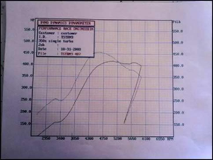

At least on my car, the engine from the factory dynos around 270 horse. On a chassis dyno, it will show anywhere from 185 to 200 horse, so its losing 25-30% in the drivetrain. Keep in mind this is for a full time AWD vehicle that never disengages any wheels. A 2 wheel drive vehicle will have loses that are a little lower.
The tricky part about drivetrain loses is that it doesn't scale with horsepower. If I added another 100 hp to the engine, drivetrain loses aren't going to change, its the same drivetrain overall.

Standard drivetrain loss at the wheels for a rwd vehicle is usually in the vicinity of 15%. Of course, the only way to know for sure is to engine dyno, and then chassis dyno (and have the chassis dyno calibrated correctly - which is rare). Mustang/Dyno dynamics/and dynojet machines will all result in widely differing numbers depending on setup (correction factor). My turbo 350z puts down 421rwhp and 458rwtq @14psi with 50/50 meth/water injection on a dyno dynamics dynometer.
What does this mean on a dynojet or mustang?? nothing :) But, it means I gained ~80rwhp and ~80rwtq over my previous run @8psi without meth/water injection on the same dyno - the only relevant numbers.
