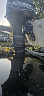

Got a pic of the boats keel and the anti-vent plate.
With an ELPT on a short transom, the motor is way too long for the transom

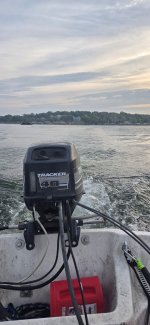

Its a 1987 Whaler Sport with a 20" transom. Does my trim angle look correct? My telltale stream isn't the best.

About the trim position, make trials in different possitions, I always used the same position in my boat and got 25- 26 MPH out of my 50 HP outboard, just by changing the trim possition to 1 higher place it jumped to 29 MPH, it was a quick easy fix, but something I didn't tried in 18 years owning that boat. It will not break anything just to quickly try.
That engine height is excellent. The L in the ELPT identification is indicative of the long (20") mid section.....best I can tell you have a 20" transom in that boat so the height is OK fine!!!
