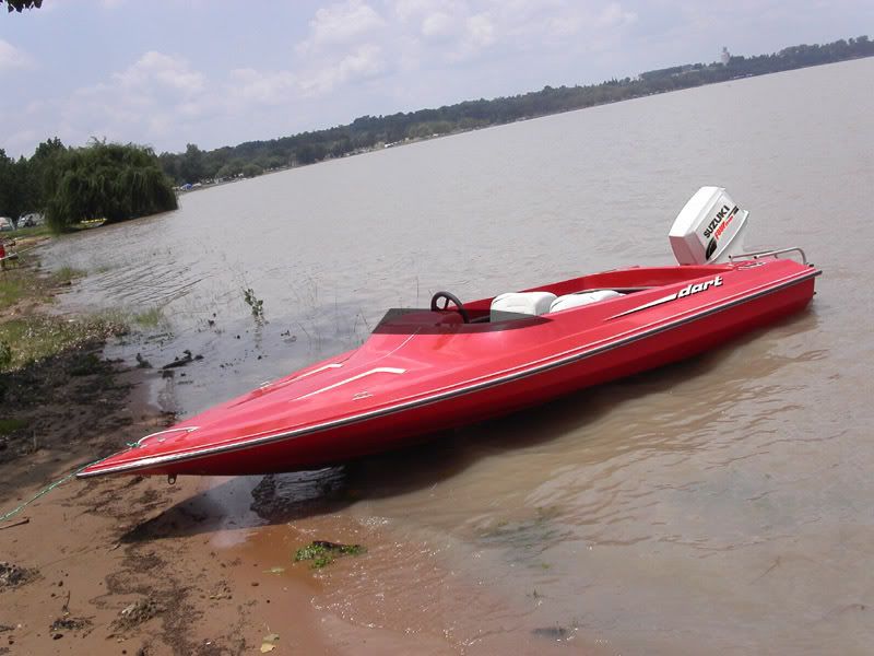

Hi My name is Ryan, I am from Johannesburg, SOuth Africa.
I just bought this boat, and have been out on the freshwater dam twice already. Had a lot of fun so far.
I have had boats in my family for years, and am fairly experienced from my youth with skiing and boat control.
What I'd like to know is if anyone here as ever heard of or seen a boat such as this flip over in the water... Why I ask is it doesn't seem as stable as my father's other speedboats he had (larger hulls)...
What would happen if I hit top speed in this (67KM/h), and just spun the steering full lock? I've done some mucking about where you spin the wheel one way, then quickly to the other, but sometimes it feels a little hairy as the boat tips at quite an angle.
Any stories? Tips? Words of warning?
The motor is a 1980 DT85 Suzuki.
Thanks

I have found that they feel like they are going over mostly in the direction of prop rotation. My guess is that is a very shallow vee, and she will slide instead of flip. Could be kinda violent as strakes and the chine catch on and off, but I am guessing she won't go over. Especially in that 40 MPH range. . . .
I had a similarly sized runabout with a 140 I/O, similar top speed. I used to go full speed and then back out of the throttle as I turned her hard over at the same time and then jump back on the throttle. You might try that to get a feel for it first. It was fun with mine although I ended up ripping out lag bolted motor mounts . . . :eek:

Sure, you can flip that boat.
Especially if it is not set up correctly, and/or you hit a wave or get slapped by a gust of wind while turning it.
Perhaps you should look at the motor mounting height to make sure it is mounted high enough, and set the trim propperly.

Well, If you really know what you are doing and really want to, then it is not difficult at all to flip it. But you really need to want it.
A couple of sharp wakes, a little alcohol, (preferably in a so-called indestructible teen-ager)-----and over she goes. Nature's way of getting rid of the chaff.
Under normal conditions, with a normally careful human pilot, that very pretty hull should be able to keep the wet side down. At 40 or so, that hull will be relatively stable.

Oh yeah! What will probably happen if you turn to lock at 67 KPH? if you turn to the left, she will probably dig in, then bounce and skitter sideways while rocking the hull. You will be slammed against the gunwale and most likely bruise your right elbow a good bit. If you keep up the turn, as she crosses her own wake, she will get real unstable and bouncy--possibly enough to throw people out of the boat. Since the boat can not turn as well to the right, the effects will not be quite as bad, but still objectionable. It is not a wise maneuver to attempt--especially with passengers.
By the way, the boat in my avatar is going about 60KPH-40 MPH. And I have put her into hard turns at speed.
