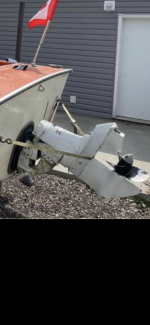

Post a pic of the drive. ( And stand back 10 feet from where you think you want to stand to take the pic)

In the bill of sale he said it was an 81 but I have my doubts about that. This is the best picture I have of it right now

That's more like a early 70's.

Those electric shift drives were last marketed in 1977.-----They are not well loved / respected today.
