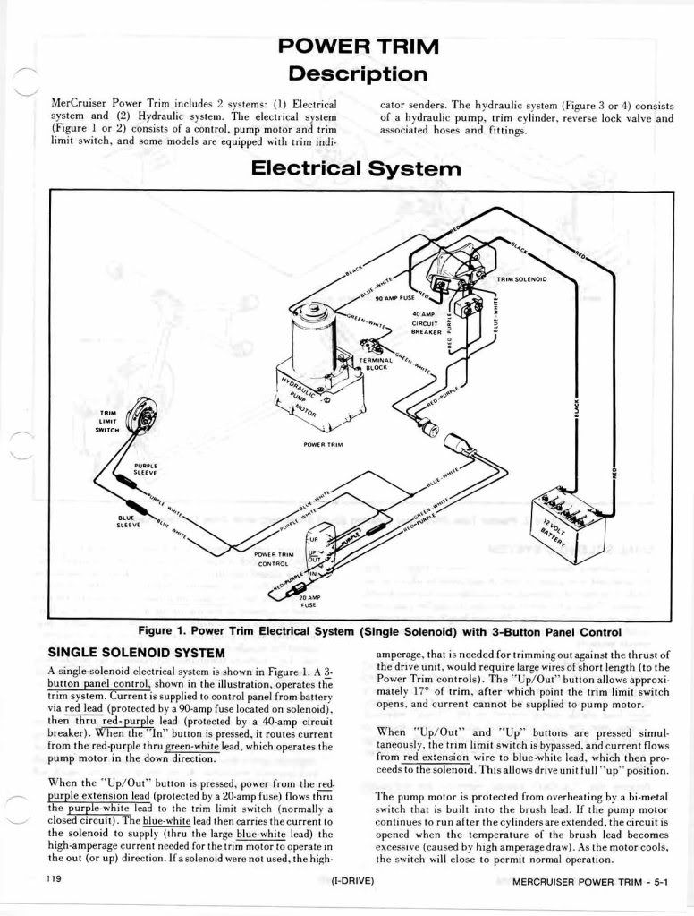

Here is a page from Merc service manual #4 that explains how the single soleoid trim system works.

Re: How does the trim system work? Merc 470
Thanks Don! That's exactly what I needed! I only wish I had had the chance to download manual 4 before they disappeared. :( Ah well.
