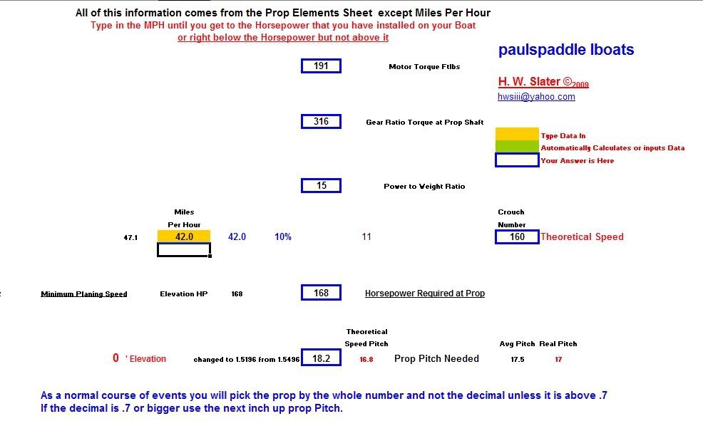

Paul, if you gear ratio is 1.65, please verify this. Then I recommend a Solas aluminum 4 blade prop in a 17" pitch, and you should turn right at maximum RPM with very little prop slip and do close to 40 MPH.

For your particular uses this will be the prop you can use ALL of the time and it will work well for your uses and needs, instead of having to change props regularly.
And take the whale tail off, you won't need it, and it probably slow you down that deep in the water.

Thanks for taking the time to run the numbers. Interesting.
I agree with the recommendation. Brand and style although I am surprised you recommended 17" pitch.
It's also interesting that you suggest taking the whale tail off. I thought this was there to help with the hole shot by keeping the bow down? Albeit it does seem to make sense that it would take 'something' away from the top end.
I need to verify the gear ratio. The number I gave I got from the service manual. i think I remember reading that there is a manual way of figuring this. Will have to look for that.
