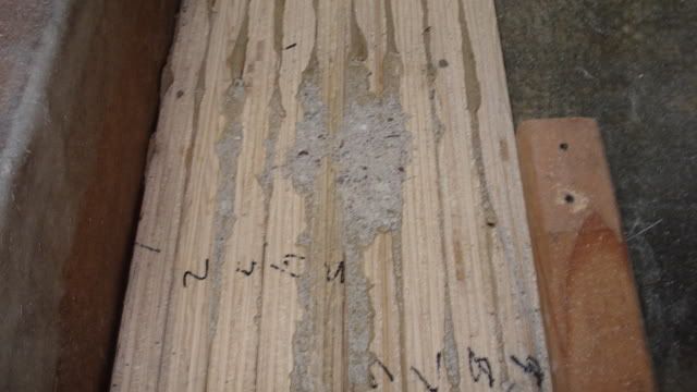

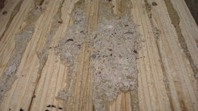

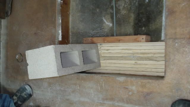

So yesterday we figured out exactly how strong PL premium was. Just thought everyone might wanna know :)
We PL premiumed the bottom half of our motor mount in and to keep it down we put 2 cinder blocks on it. We knew the PL would squish through and contact the cinderblocks but figured who cares we will just rip them off later. Well it was a flawed logic more than likely due to being tired and having a case of the f*%#-its.
The brick in the pic was laid back on for the picture after we got it off, but it took 2 5lb sledge hits, 2 or 3 big kicks, and then finally broke the brick after some rubber mallet hits.
So when people have a question on what to use to glue things together or are wondering if it will hold their transom to the back wall the answer is PL Premium and YES.

Yep, it works well.
Just FYI, I'm currently tearing apart some repairs from two years ago to make way for a transom re-core. That includes a deck attached with PL and other parts attached with epoxy glue ("peanut butter").
The PL is far weaker than the epoxy glue... easier to break apart, even though the underlying materials usually are what fail (go figure).
But it's still probably stronger than most boats need, is pre-mixed, cheaper than epoxy, and comes in nice tubes.
For myself I'll use it only when I'm doing something cosmetic or trivial since I want my boat to be as light and strong as possible, and globbing on PL won't help with that. It's also not possible to grind and paint PL.
PL also doesn't span gaps like epoxy putty can... it's a glue, not a filler or casting material.

I decided one day after framing that I didn't like a stub wall that I put in with a Hilti gun and PL400. I wanted to change the angle of the wall and just knock it down and reframe it. The wood and PL went with the cement as I tried to move the wall. The PL would let go of the concrete and the 20 year old concrete pulled out in chunks.
Make sure it is given time to set...and that stuff is going nowhere.
