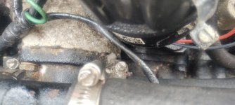

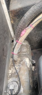

Went to change my fuel filter today and discovered fluffy white mold all over the starboard side of the bilge around the gas tank and on the thermostat housing:16206.jpg
For this situation, what's the best solution? Or will it resolve itself with time and use once the season starts?

It's on braided fuel hose surfaces (filler and vent hoses), the painted fiberglass bilge wall, and a gasket joint between a painted cast iron thermostat housing and a cast aluminum intake manifold.
Per further review some of this was "dormant" in the past... seems the current temperatures and abundance of condensation has woken it up?
