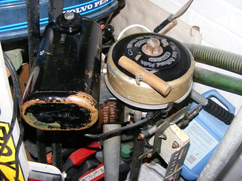

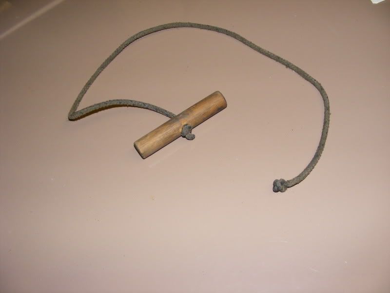

Re: How to make a starter rope?
As shown below.
Be sure the cord is thick enough for the turns to only be able to lie one on top of the other.
kenmyfam
Aug 10, 2006
14,398
Ah, the good old British Seagull !!!!!:D
Indestructible :D
Bit of wood a couple of good knots and voila, starter rope.
