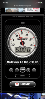

Scott. We have discussed similar many times I’m sure. I totally get what you are saying, if you’re talking about a perfectly set up, built and adapted carb engine to compare to an mpi…but out the factory installed engines in boats…there is no doubt that a 4.3, 5.0 or 5.7 mpi all have more power than the carb version. Mainly because they run higher rpm ranges. The specs and figures suggest they are better on fuel. But I agree that should a guy manage to set up a carb to have absolutely zero fuel wastage…it may be possible for the same engines…carb and mpi..at the same rpm…to be as efficient as each other. But that would have to be a perfect world situation for the carb.
Efi tbi engines would be comparable a little closer to the carb, I’d think.
QBhoy
Mar 10, 2016
8,348
Difference between the two 4.3 gm in carb and mpi format, when they were available at the same time as an engine option. Both the same rpm. Carb is 5 gallons per hour and mpi is 4.5
Interestingly they both have the same rpm range. Also I’d add that the mpi at 4800 rpm uses a little more fuel than the carb at 4800 rpm…but it’s making 30hp more whilst it’s at it.
