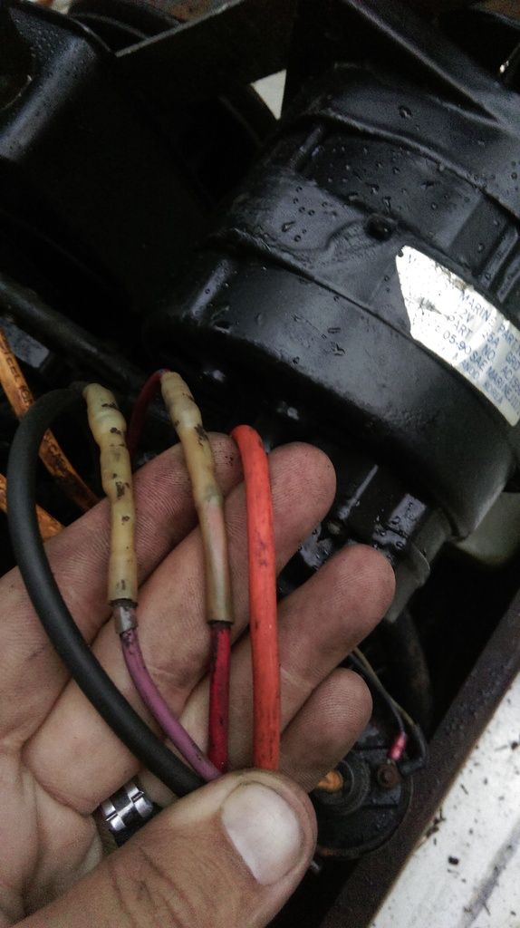

After researching alternator wiring and from what you said earlier Bruce, I think it should be-
Connect red to orange via jumper,
Run black wire to ignition
Thick black to engine or battery ground
Does this sound right?

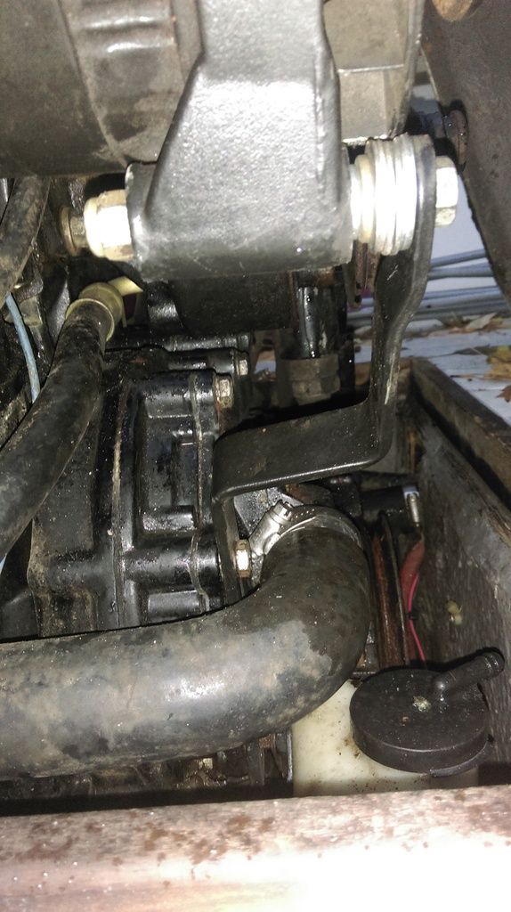

Picked up the alternator, it came with the harness also still connected so at least I can see how it was wired previously. Going to mess with it now. I still gotta fab brackets for it too. It came with the one adjustment bracket so maybe I can make that one work and make one other bracket. I'll post pics soon

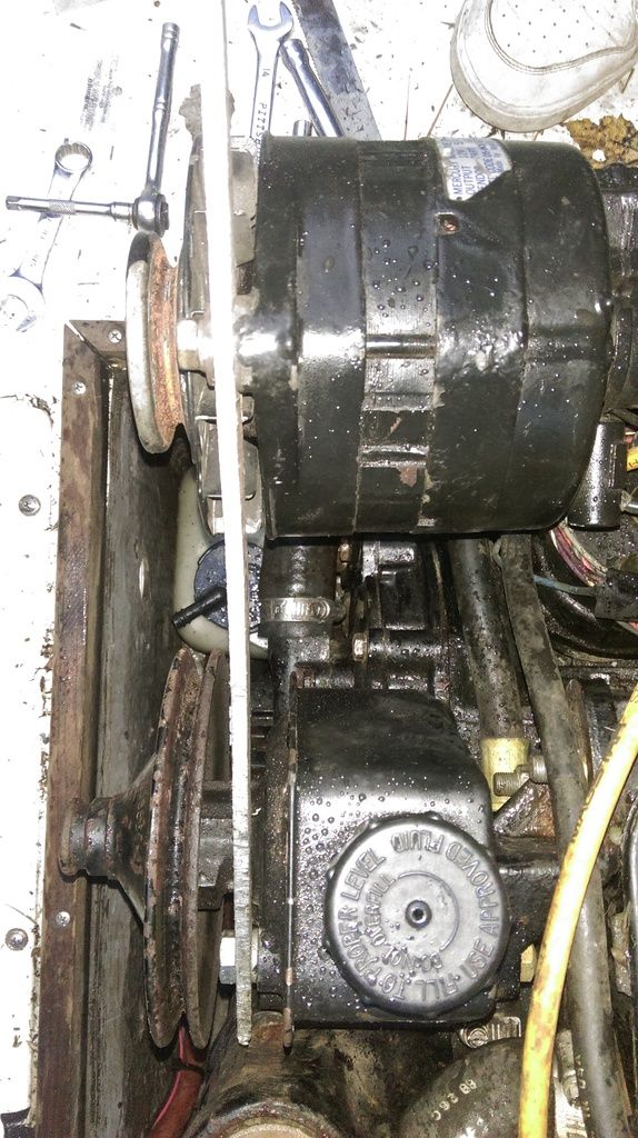

I used the one bracket that came with it, couple washers for spacers, and it works ok for the lower.
Used 1/4" x 1' flat bar and bolted to top mount and behind ps pulley onto pump.
It's on there, but don't like it as is. It's gonna vibrate to much.
Went and got more flat bar, I plan on bending to a 90? at one end bolting to top mount flat bar I made and bolting other end using intake manifold bolt. This should sturdy it up good I think.
Then I have to test fit for a belt, and wire it up.

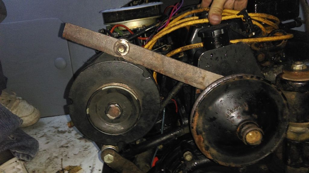

don't laugh how ugly it is lol
It's just a mock-up right now. I'm gonna cut it down, round the ends and edges and paint the brackets.

Your biggest issues are going to be belt alignment, vibration under load and how are you going to tighten the belt. Thats where a friend with a plasma cutter, like me, comes in handy! :)

I eyeballed it the best I can for alignment, I think it needs one not washers spacers. I'll know more when I get the right belt.
I'm hoping the ps pump will still adjust belt.
And i wish I had a plasma, I'm struggling with sawzall and grinder lol

If vibration occurred , would it break the timing cover I have it mounted to? I'm kinda nervous about that now! I'll have to overengineer the craps out of it to have NO vibration lol

Ok got it all mounted, got new belt on wired orange to starter battery lead, and the red wire to same stud on starter. Wired purple wire to electric choke.
Started, runs and charges 12.8 at idle, 13.9 revved a little bit. Checked everything and noticed alternator is getting hot. Just about to hot to touch. Also orange wire is a little warm, but I think it's fine.

Could it be bad ground? I ended up grounding to the brackets I made.
Also, I've read stuff about a resistor in the purple wire I believe? I'm not sure what this is or if I have one. I know I didn't add one myself.

There should be no resistor in the purple wire going to the alternator. It needs full 12V. Your ground is likely fine. Just th eground from the brakets themselves is good enough. The ground wire just makes sure.

With the extra bracket i added it just barely shows vibration. Should it be rock solid or is very little vibration normal ?
