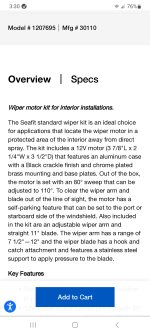

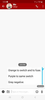

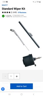

Made a search and have been unable to find any instructions or diagrams.
Does appear you wired it correct, guess the question is I've seen nothing that tells me it will park
Thank you. I've looked everywhere for the instructions, too.

This may help.
53,063
Not sure, however
Orange is battery feed
Purple is ignition feed
Black is ground
And single speed wipers only work in slow mode
