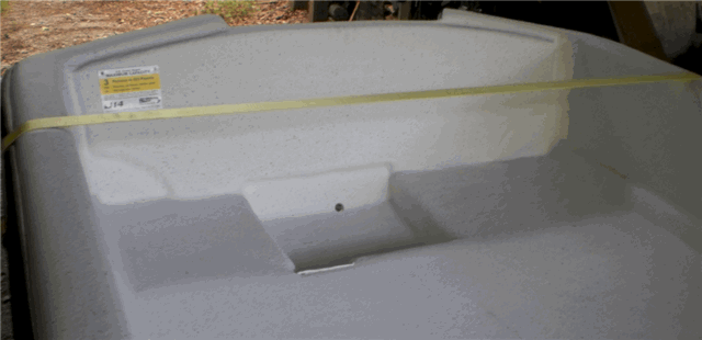

I just picked up my Carolina Skiff J14 at the factory today in Waycross GA. It had just been made and has not been exposed to any water or rain. They do not sell direct, but I picked it up for my dealer in NC.

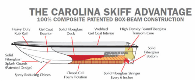

The Carolina Skiffs have this hull:
Many owners have complained about water getting into the hull. Most think it is due to improperly sealed screwing into the hull, however there is some evidence that the cable chase can also function as the pathway for water intrusion. The cable chase is open at the motor area but you would have to drill through the floor at the center console if you put one in. I just have two bench seats and no center console.

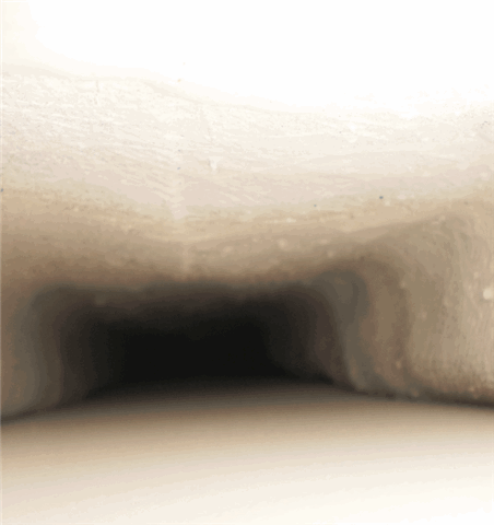

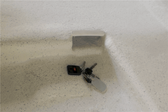

The inside of the cable chase hole looks like this:
It is very important that no water increase the weight of this hull as it is going to be transported on a truck rack. My plan is to not drill into the floor for any reason and to seal this hole. I have never worked with fiberglass, but I am pretty handy and enjoy reading and following directions. The trouble is, I don't know what I should do to seal this hole or what products to buy. If you could be specific it would be very helpful. That plastic strip at the top of the hole appears to be covering a raw edge and could be removed to expose the fiberglass.

I'm sorry I was not clear about it. I don't want to ever use this channel for anything. It is off of the sump, so any ocean splash or rain while in the water will wash into this hole and 8' or so forward. I see 4000UV works well with ABS. I can buy a block of ABS that will go into this hole about 2". Then lather it up with 4000UV, insert and caulk the crack with 4000UV.

I got ya, I would make a block of that ABS stuff that overlaps the hole top and bottom since there's a lip there buttering it with the sealer Do that instead of putting it inside the hole just in case someone kicks it so it doesn't push in and jar loose.
