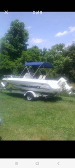

Looking at a yamaha vmax 175 hp 2 stroke hpdi 20 inch shsft. I have a wellcraft 190 ccf with max hp rating of 150. Is this a bad idea? Looks like It weighs about 100 lbs more than a 130 yamaha picture is my current setup

About 12 hrs ago you were going to stick a 25" Motor on this boat. Having multiple threads on your Repowering is going to be a Problem

Yes, not a bad idea but not a smart one. Imo the incremental gain is not worth time and effort. You are right at the sweet spot for actual hp to recommended. I have a 50 hp on my 115 rated so i might bump up someday. If i was at a 90 or 100, no way id upgrade.
What are you trying to achieve? How often do you run WOT? Have you looked at changing props to achieve your goal?
Some states consider overpowering the rated capacity reckless operation regardless of how diligent you are w the throttle.
WV is 1, is Maine?
Theres a reason for the 150 max rating
52,485
Is there a problem with the 130hp? Or is this a desire to go faster?
If you want to go faster, many times it requires a different hull

Ok so I'm leaning towards the 130 hp. Sorry for multiple threads
Don’t worry Maineiac, you are actually dealing with 2 different issues and trying to determine which motor to go with. I think your best bet is to change the shaft and go with the right motor for the job.

Well after all this I did buy the 25 inch motor but I'm going to resell it. Found a 20 inch 130 hp I'm going to buy. Thanks for everyone's help and input. Here's the 130 hp 20 inches
