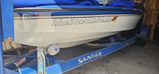

I've used the Star Brite Instant hull cleaner with great results. Our lake has a lot of tannins that stain my white gel too. I use TB cleaner in the fall to clean the calcium deposits off the motor, but it didn't take the tannin stains off the hull.
Make sure you wax after or the stain will return even worse. I had a great time waxing the entire underside of mine this spring. It sits low in the trailer and required some creative jacking and blocking so I could get under the trailer.
