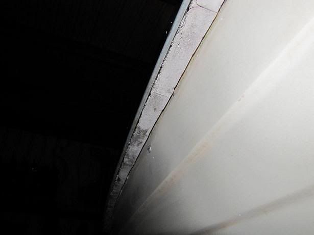

sphelps
Nov 16, 2011
11,475
Re: Hull to Deck joint loose
Is this the stuff? I don,t think there are screws holding the cap on . It,s just the white PB looking stuff.
adoseth
Jan 15, 2012
109
Thats it Sp, no screws? omg, by the way what is PB?

GT; basically my damage looks the same as Sphelps photo here on this thread, on the area that is loose it looks the same as the area that is tight, looking at it from the underside like sp's photo, another question, i would like to take the boat out and test the engine before i get started on the hull repair, could i do that without cracking the boat apart?

sphelps
Nov 16, 2011
11,475
Hey , Adoseth, has the hull came completely loose from the cap? If so you may want to lay some glass at the connection point inside the gunwhales . You may have to remove some foam to get to it. With it glassed in the outside should not matter much unless you want to dress it up alittle.
