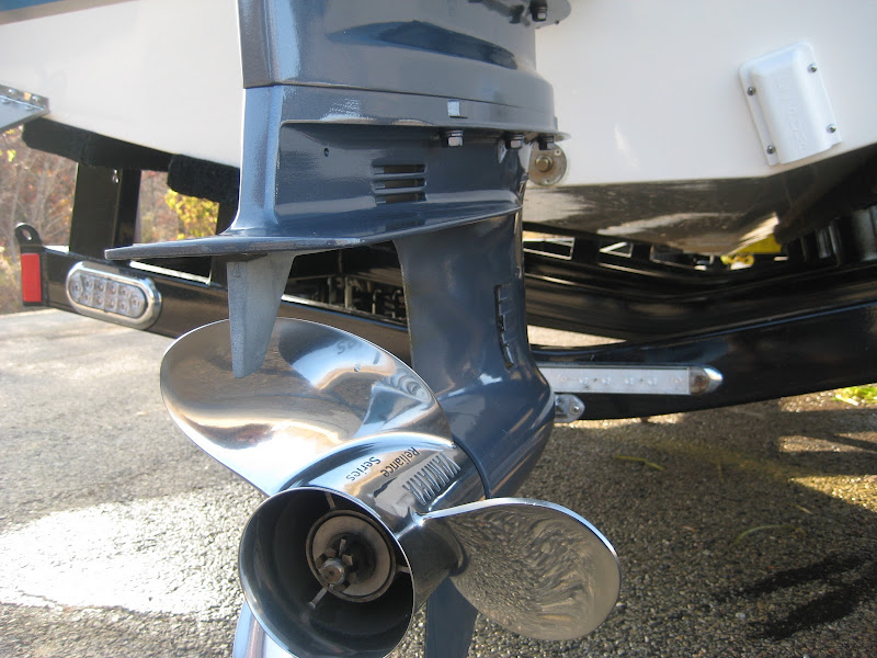

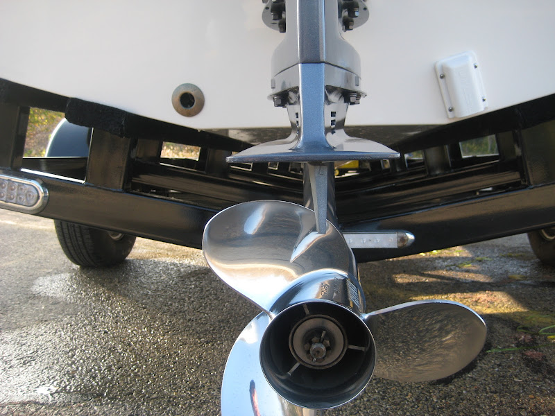

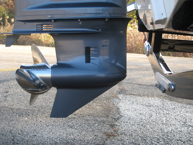

Anti-cavitation plate: See pictures below of my Hull. It seems to be ~ 1" or possibly 1.5" lower than the keel. My deck boats modified V hull doesn?t have much of a true V keel? Kinda flat (seen in pics)? It's also possible due to this design of hull, that the engine is mounted at the correct height, I'm just not sure... Nothing on Hurricane web-site or owners manual notes mounting height for this hull. My Yamaha factory service manual states "the anti-cavitation plate should be even with bottom of the boat" So should I move the engine up with 4 blade? Less resistance correct? Curious why the dealer rigged it this way???
