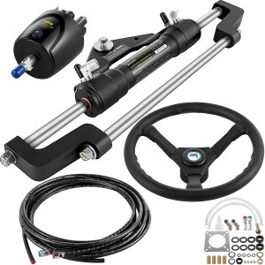

Gang i would like to change the steering over to hydraulic on my trophy 2002wa. I have the force 120. Can those who have done the swap confirm this will work with the force? It seems the 20 foot hose version is on sale so can excess hose simply be spun into a circle to adjust for shorter runs?

It’ll work, being you have a standard steering tube. But I can’t imagine a Vevor setup being a good idea… I bought their rotary steering which is advertised as no feedback, but it’s not so I might even have to chuck my simple rotary steering in a year.. boat cover from them is awesome tho

I'd contact Vevor and ask about fitment??
Hyd. steering is a great addition to any boat, however it can mask a problem with the motor locking up and being hard to turn.
99% who own a boat don't have a grease gun or know how to use one.
Hyd. steering will MAKE the motor turn because of the strength of the unit.
Grease the mid section a bunch. In salt water?? more grease and more grease.
