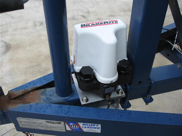

I will answer since I actually have an EOH on my trailer.
I have a Titan Electric/hydraulic controller on the Wellcraft trailer in my signature. I wanted to use Kodiak Disk brakes and no surge since I wanted to use a weight distributing hitch. Although there are WDH's made to work with surge brakes, they don't work as well with them on.
The downside is that if someone else wants to tow your trailer, they have to have a controller in their vehicle. There are no other downsides.
I hate drum brakes. One of the reasons, I would never but electric drum brakes on a boat trailer.
Many high dollar 5th wheel Mfrs are putting EOH along with disc brakes on their trailers.
