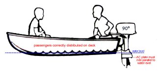

-Trim motor to 90 º usually second/third orifice out transom, brand sticker should be parallel to water level.
-Sit a boater mate up front for better load distribution, go for a wot run on flat calm water condition...
pull your head side of motor and check at which lower leg's plates is the water flow passing once on plane. Can sit on deck close to transom if with fear doing same while sitting on aft tube portion. Take a pic if possible...
-Excessive prop aeration is due to an exposed AV plate as in pic, confirm the water flow is passing slight under or slight above the AV plate to go from there. Know that Sib brand and size well, a friend of mine had the same issue running a Tohatsu 30 HP motor on it.
