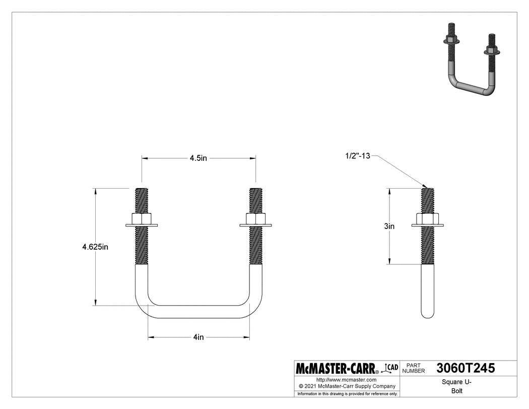

Would this work?
Mount TypeThreaded
Thread Size
click to learn more about
1/2"-13
click to learn more about 1/2-13
Inside Width 4"
Height 4 5/8"
Thread Length 3"
Capacity2,000 lbs.
Material Galvanized Steel
Center -to-Center 4 1/2"
Leg Diameter1/2"
acarleson

@roscoe that looks like it will work! I have no idea how you found that, I thought I scoured mcmaster-carr and did not see anything. Did you find it on their site or somewhere else?
Thank you!!!
roscoe
Oct 30, 2002
21,936
Just went to their site.
Its the one I posted a link to in my first response.
Here are all their square u-bolts.
Anyway, get to work on that trailer, its time to go boating. :)
