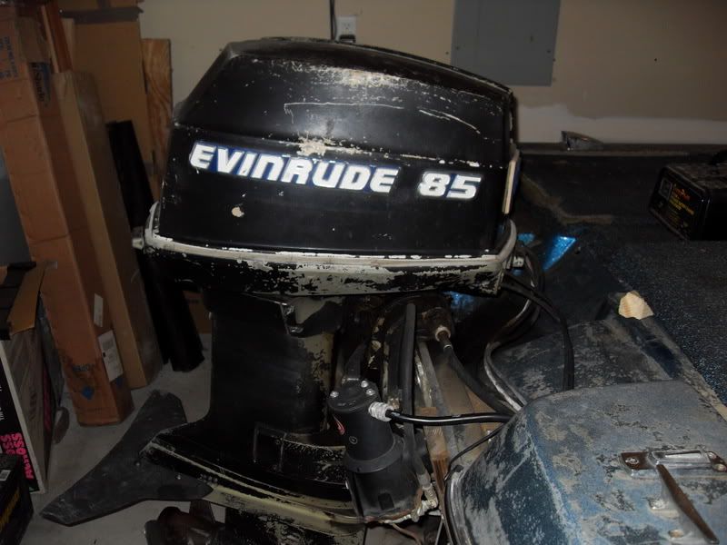

I'll spare you guys the dirty details. Because, I'm really ticked that I got caught up in the moment. I truly believe the most honest person will lie their butt off to sell a boat. So this motor is a 1976 85hp evinrude 85693g w/cooked piston. Thank goodness I ended up with motor control (omc) looks like I can sell that along with lower unit on eBay. Before I dump this on someone else, I'd like to do a pressure test on the lower unit. Do I purchase a tool for this or do I make one up? Also anything else I should pull off this motor? Prop is ss but no brand or numbers on it. Thanks to all of you for helping. I don't post much but I've been lurking for about a year. I should have known better then to give any money without doing a compression test.

When checking for potential leaks in lower units, it's good to do two tests, a pressure and a vacuum test. Their tests require that the gearcase hold both vacuum and pressure for so many minutes to insure that the case won't leak. You may want to have a marine shop do that for you. Remove the lower unit and take it to them.

That engine has a rather rare power tilt unit on it. That may be worth what you paid for the engine.
The last engine I parted out (ebay) was a 1988 Johnson 60. I broke even.

Pull the entire ignition/electrical system (stator and wire harness) and post it separately. Flywheel (separate). Carbs (separately as a set). Manifold & reeds (separately as a set). Crankshaft (separately), Conencting rods (separately)
transom bracket with tilt&trim (sep), head & water cover (sep) upper housing, (sep), comlete lower unit minus prop (sep) finally the prop. Post everything on E-bay and/or Craigs list. Do the research to see what this stuff is currently selling for.

Does your '76 have power Tnt? If so, that's worth $400 by itself if it works.
