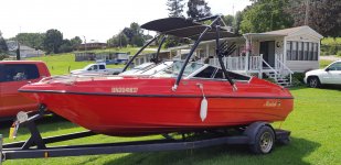

Hi All
K so I had to swap out my outdrive this year. I have a 97 Mariah 18' bow rider. It has a 4.3l lx Gen II engine and an Alpha 1 Gen 2 drive. Last year's drive was a 1.63 ratio, with a 17" pitch prop. The hole shot was amazing and top speed was around 60k. Although I could over Rev it if I wasn't careful
This year the new (used) drive is a 1.84. I used the same 17" prop cause that's what I have ... took it out and it ran like a bag of poo. All my research says that the 1.84 drive should be a better ratio for the V-6 engine, and a 17 pitch prop is pretty light I think. So what the he'll !!!

At the end of last season it blew the oil hose to the drive and water must have got into the lower gear case, and it froze .. I tried to get it rebuilt but no dice .. now I'm thinking swap out the top end of the old and bottom end of the new.

Oh I don't drive like that .. we use the boat for wakeboarding and top speed for that is around 20 mph. but the hole shot is everything ... 19 is the correct prop. But I dropped it a notch to find 1st. gear
