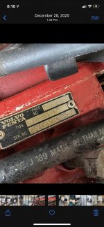

This post and the other one I couldn't find where
you listed a year, model# or any way to ID the boat/motor??
A red motor, they were produced in the 80's
What we working on?
Pic of the drive?
MalibuMike
Dec 29, 2020
137
What we working on?
Pic of the drive?
1997 Parker 2520 Volvo penta 5.7Gi-f

Doesn't look to bad
The S/N will help much if questions come up
4012191678
