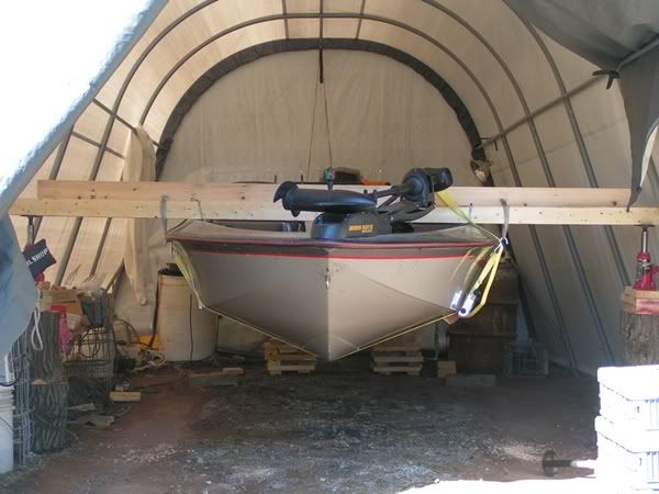

You'd be amazed at what you can do with some blocking, a wooden bridge beam, and a handful of $20 bottle jacks.
Here's a 150 HP bass boat levitated in the shed. Trailer is being welded on and wired elsewhere.
