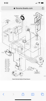

So basically i got a mercruiser 470 and i wnted to rewire it and found that picture but i dont get the wiring between the starter and the slave solenoid can anyone help ?? Thanks

just wire it like the picture. slave solenoid goes to the S terminal on the starter
coil gets wired to the I/R terminal on the starter in parallel with the resistor wire.

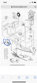

So with this diagram wich do i have to connect to run it and btw the engine is outside the boat

Ok so i wired it like the diagram well only the parts needed to start and well when i put the wire to the battery the slave solenoid just clicked but when i shorted both the small studs on the slave solenoid it cranked the engine but no spark but i still presisted until i got it to sparj like 3 times but that was it , so umm would anyone know what the problem is would love for your thoughts
Ayuh,.... Welcome Aboard,..... Ya need to service the Points,......
