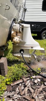

Tried muffs to see if leaks. Nothing inside. Is water supposed to spray out like this?

As far as I'm concerned, most Stringers on muffs look like a porcupine of water. Did you confirm you were getting flow up by the engine? (or at least it stayed cool?)
