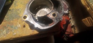

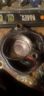

Ok, me again...so I installed new impeller kit (including housing) a few weeks back (albeit without any grease, duh)...
I went on to tackle new starter and altinator on my 2.3 in the meantime.
So I get her to idle finally. I put her in the river...idling...but as soon as I shift into forward and throttle up she bogs and dies.
Ok, so I check the impeller and I find it was jamming my drive shaft (see pictures below)???
Has anyone experienced such? I can't make sense out of it???
Please share any insights if there are any. Was it the mere lack of my greasing it up that caused such??? I mean the casing has melted, the water flow vanes have moved this impeding water flow. Etc.???

It looks to me that the liner is out of shape or is it the angle of the pic? According to OMC the narrow end of the water pump shaft should be in the 6 o'clock position when installing the impeller. That will avoid having to twist the cover into position which can cause the o-ring out of the groove on the cover. If that happens the pump will suck air causing an overheat condition. That's how I always installed one & I never had a problem. Also turn the water to muffs on BEFORE you start the engine. You should see a pee stream from the lower unit even with the engine off.

You are correct in that upon removal, I found the housing spun or was forced to about the 2:00 position?*#? The internal wall of the housing was or had some melting inside as well. So I am not sure how to move forward...any suggestions?

You need a new impeller housing, seal for the groove, impeller & liner. And don't ever run the engine unless it's on muffs unless you want to keep changing impellers. It only takes a few seconds to burn one up. And always carry a spare. They're a piece of cake to replace on a Cobra.
