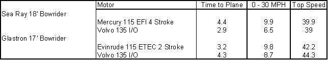

You will find it beneficial to do some research on similar boats powered by outboards and I/O's. If you compare a 1000lb 140HP outboard fishing boat to a 3000lb 140HP I/O bowrider don't be surprised if the outboard wins. You're giving up comfort for performance. But you'll find that in similar boats the HP doesn't know what kind of motor it's coming from, performance is the same.
It's hard to find a direct comparison, but for example, Boattest.com has tests on an 18' Sea Ray bowrider powered by a 115 HP Mercury outboard and a 135 HP I/O. They also have a 17' Glastron bowrider powered by a 115 HP ETEC and a 135 HP I/O.
