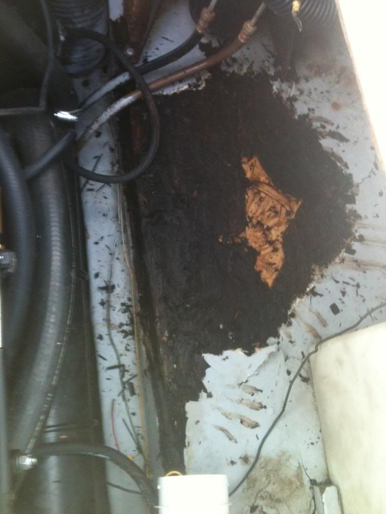

Wow, it happened! Cool, now please note on this phot that the fuel tank does not have wood over it anymore, thinking I should cut a piece and place over it again.
The wood rot is on the right of the picture. I will post another after I removed the battery and started digging!

Re: Inside area of engine compartment is rotting...
I am down to pretty hard wood, I do not want to remove the engine at this time so I need to repair what I can as is. Thinking I will place some treated plywood over it, not sure how to secure it down, then seal it over with fiberglass. Seems to be foam underneath the wood. Comments?
