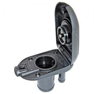

I have been eyeing that same filler. DeepBlue recommended metal instead of plastic, but I'm not sure why.
Woodonglass
Honorary Supreme Mariner
Dec 29, 2009
25,933
Plastic has a tendency to break down due to UV rays and action from the water etc. If you keep your boat covered and you're not on the water a whole lot, a plastic one will last a good long time. You can Acetone wash it and Paint it too and then the problem goes away!!!:D
Arawak
Aug 27, 2010
486
Ah, ok. My current plastic one has lasted 26 years so I'm probably good.
DeepBlue2010
Lieutenant
Aug 19, 2010
1,305
True, but keep in mind that your plastic one that lasted 26 years wasn't made in China using the cheapest possible material on planet earth. Even if it was, I doubt the quality control standards were as "forgiving" as they are now. When it comes to fuel, I prefer to stay waaaaay on the safe side but this is just me.
